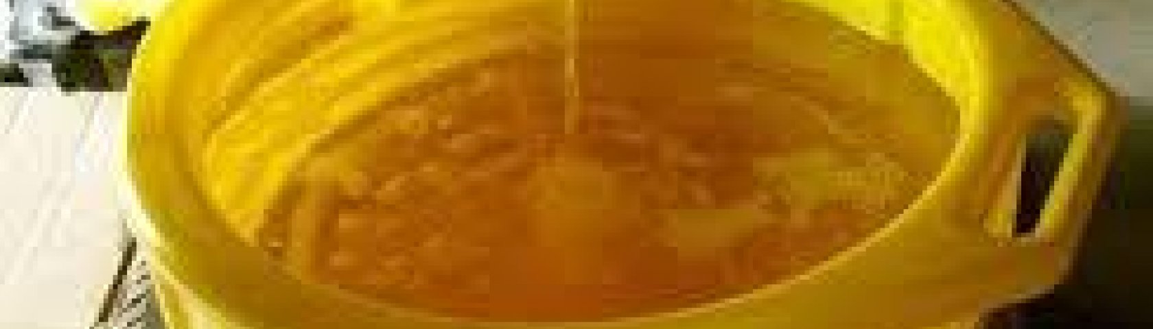

Fuel system/Engine
Ideally the petrol in your tank should be drained to stop a build up of moisture in the fuel, together with your carburettors. An alternative is to fill the tank up and add a stabiliser and follow the instructions by running your engine to insure the stabiliser reaches all throughout the system and is present in the carb bowl. With regard to the engine it’s a good idea to change the oil and filter. Old oil can have acids suspended in the fluid which can be potentially destructive. It’s also a good idea to remove the plugs and spray some light oil into the cylinder bores.
