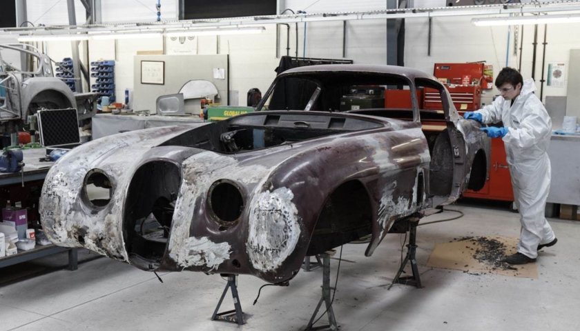

When it came to actually restoring the car there were more than a few challenges. Since the car was a bespoke build finding new or original parts was impossible. Luckily the team at CMC found photos of the car from new and could craft bumpers and chrome sections from hand based off old pictures, but it was far from straightforward. Many of the smaller components like the front and rear lights were custom builds so CMC 3D scanned the front and rear of the car to create some new lights that would fit the body and match the original design.
Nsh Pinin Xk 5
Once scanned the necessary parts were 3D printed in-house according to CMC Chairman David Barzilay, who quoted that up to 80 per cent of the chrome trim had to be remanufactured for this car. The restoration was one of the more in-depth projects undertaken on a Jaguar, requiring a full rebuild of the car’s front end, new rear quarter panels, inner arch panels, boot floor, sills, door skins and door cards. It’s getting easier to see where those 6,752 hours were spent.
Due to the car’s condition and previous attempts at restoration CMC were faced with a couple of key challenges – they didn’t know how original interior was trimmed, neither did they know in what colour the exterior was painted. The answer to these questions was found once they had properly gutted the car.  Barzilay said that “There were no signs of the original paint colour until, when the front screen was removed, we discovered a small section of original paint and used it as a colour match” and similarly when they were gutting the interior found a small section of ochre tan leather from the original seating.
