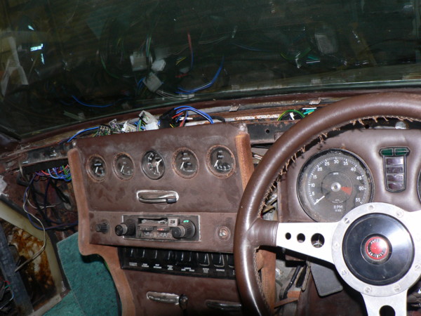

Touched base with John Ostick at JDO. To save anyone else having to compile an order for XJ6 series 1 complete set from John's website (send him a pic of your dash to make sure you're getting the right bits) here's how my order panned out:
2 off JDO5S 5" ½ vee chrome @£14.95 each + sponge gasket @ 0.85p each = £31.60
1 off Kienzle clock bezel per pix @£10.95 second hand = £10.95
4 off JDO2S 2" ½ vee chrome @£ 4.95 each + sponge gasket @ 0.50p each = £21.80
1 off post & packing @£ 4.95 = £ 4.95
= £69.30
No VAT :wink:
The Kienzle clock ring will be a cleaned second hand one, no new stock
Ugh! The "before"
