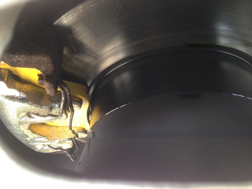

Postby robgx300xjr » Fri Apr 22, 2016 6:54 pm
Quick Update
After a long chat with EBC on the phone - very helpful technical department.
I have dived in at the deep end - On their advice I have not gone for the grooved or grooved and dimpled discs. Simply because they advised the noise under breaking is very noticeable with this type of disc. And after explaining my usage requirements they believed the extra cooling not of massive benefit.
They did recommend the yellow pads over the new red ceramic pads - as it's a low mileage per annum, with short bursts of heavy braking.
I'll keep you all posted - they should be fitted and run-in for Precott :D
1997 XJR X300 Manual
robgx300xjr
Posts: 54
Joined: Thu Oct 09, 2008 1:26 pm
Location: Leicestershire
Re: XJR - Brake disc options - considering EBC
Postby robgx300xjr » Sat May 14, 2016 4:07 pm
EBC Discs, callipers, front brake hoses and pads on - need to run-in. See how they go up Prescott (see you all there that are attending). Cheers
